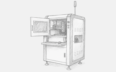

Line drawing of an automated optical inspection machine with an open access door and internal inspection chamber

Automated Optical Inspection (AOI) machines are crucial in electronics manufacturing, used to inspect assembled printed circuit boards (PCBs)for defects. Using high-resolution cameras and sophisticated image processing, these systems verify component placement, presence, and soldering accuracy. There are two types of AOI systems. The 2D AOI employs cameras capturing top-down and sometimes angled views, evaluating component presence, polarity, and solder joints. Meanwhile, the 3D AOI incorporates height measurements through structured light or stereoscopic imaging to evaluate solder volume and component height, greatly improving defect detection reliability.
Modern AOI machines typically integrate both methods to minimize false positives while maximizing detection accuracy.
