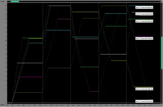

MotionScope
Plots data from any address on the motion controller. It is similar in its presentation to an oscilloscope. Used when developing and troubleshooting motion control systems.

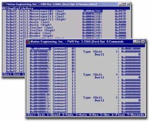

The VM3 utility allows you to view and alter data stored in memory in either the RMP, QMP, or ZMP controllers. The VM3 is especially useful for locating memory addresses for plotting custom signals in MotionScope. When using VM3 to alter data on motion controllers, exercise extreme caution at all times.

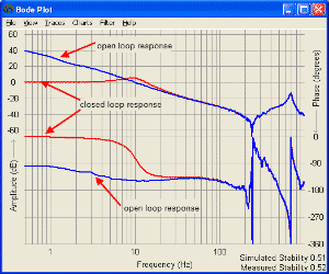

BodeTool
The Bode Tool is a utility that makes it easy to get frequency domain data from your system. The Bode Tool makes it easy to get the data a controls engineer needs to set up and tune the control system properly.

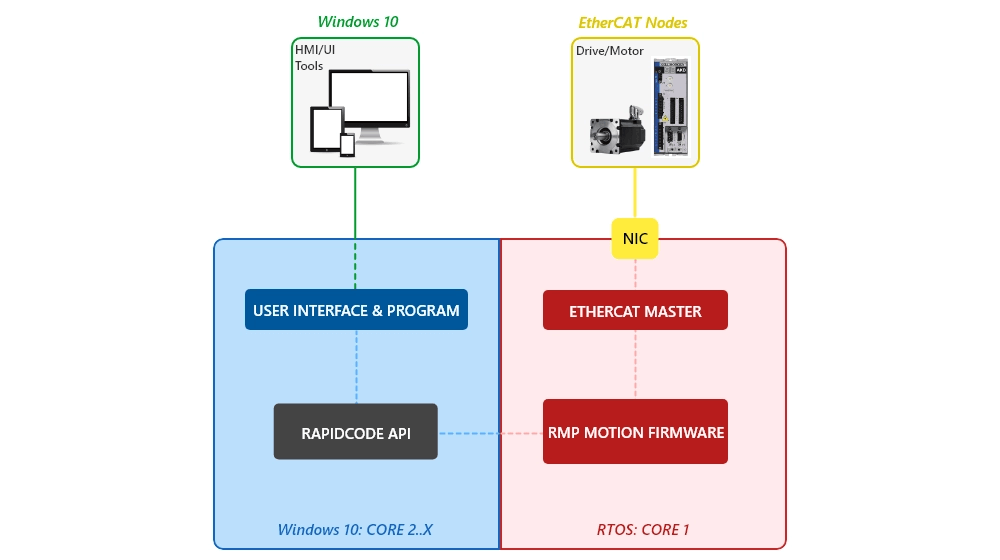

  • The most popular and default motion controller configuration.
  • Your application (UI or HMI) has been developed in Windows.
  • Allows you to leverage RapidSequencer for Windows. (non real-time configuration)
  • Need a high-performance machine for real-time and deterministic needs.
Configuration Diagram
Definitions
Architecture Diagram
(Click image to expand)
User Interface & Program
Customer-created user interface and machine control application.
RapidCode API
C++, C#, VB .NET API for intuitive development.
NIC (EtherCAT)
Ethernet-based connection to EtherCAT® slaves on the network.
EtherCAT Master
Connects the master to slave devices using CoE (CAN application layer over EtherCAT®).
RMP Motion Firmware
Low-level operations for RMP’s motion controller memory.
  • Your application (UI or HMI) has been developed in Windows but needs to load some user logic in the RTOS.
  • Required to leverage RapidCodeRT or RapidSequencerRT software products.
  • Need to load control logic (if/else, for/while) or instructions (RapidCodeRT, math, comparison, etc.) in the RTOS.

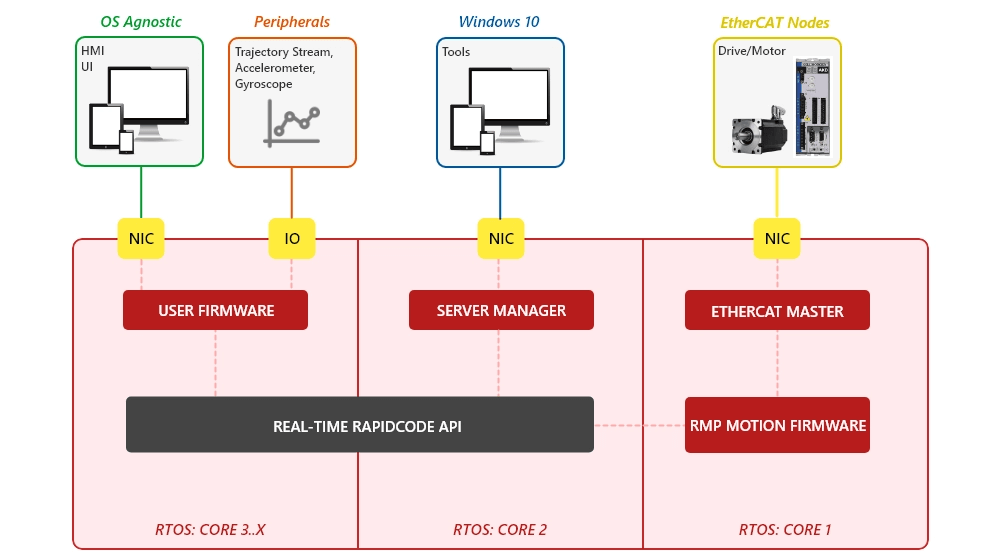

  • Your application (UI or HMI) has been developed in a non-Windows OS (ex: Linux, VxWorks, Unix, RTX/RTSS).
  • Your motion application will run inside the RTOS. Great for when every sub-microsecond matters.
  • You would like to program in C++.
  • Requires RTOS Development Kit.
Definitions
RapidCode API
Real-Time RapidCode API
The real-time RapidCode® API for the INtime® or INtime® Distributed RTOS.
IO (NIC or Serial)
Ethernet-based or serial connection (COMM: RS232, RS422, or RS485) to external devices.
NIC (EtherCAT)
Server Manager
Coordinate inputs and outputs between the Host System and Motion Controller over an Ethernet-based interface.
User Firmware
Low-level control and operation of the user’s custom program.
EtherCAT Master
RMP Motion Firmware

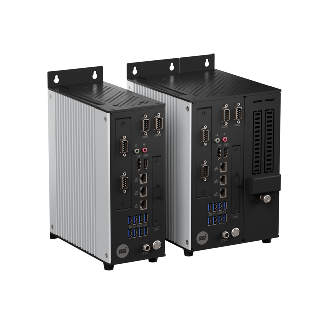

Industrial
PC
RMP comes pre-installed in a ruggedized fanless industrial PC customized to suit.
Ruggedized
Industrial PC
RMP comes pre-installed in a fanless industrial Panel PC customized to suit.

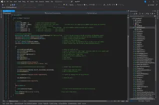

The RapidCode API
The RMP's powerful, intuitive, and multi-language Motion Control software API
RapidCode API Class Diagram
Axis
The axis class represents a single axis of motion control. This class provides an interface for commanding motion, reading trajectory parameters, configuring filter (control law) parameters, homing, limit switch configuration, motor configuration, position capture, electronic gearing and node information.
Multi-Axis
The MultiAxis class provides an interface to a group or collection of axes. Use the MultiAxis class when coordinated, synchronized or path motion is required.
IO
The IO class provides an interface to an I/O Node. An I/O node can have various combinations of digital or analog inputs and outputs.
IO Point
The IOPoint class provides a common interface to any I/O point, regardless of where it resides in the network (Motion Controller, Axis, or I/O Node).
Motion Controller
The MotionController class Provides an interface to general controller configuration, firmware upload/download, network, and data recording.
RSI Error
The RSIError object is thrown as an exception by all RapidCode classes. It contains and error number, and a text message which describes the error. Throwing exceptions can be disabled on all RSI classes. If throwing exceptions is disabled, a log of RsiErrors can be accessed.

What hardware is required to run the RMP EtherCAT motion controller? Are there any bare minimum requirements?
We recommend using our iPC300 industrial products. OEMs can select their own PCs but we recommend selecting industrial computers and use Windows IoT LTSC operating system. The LTSC variant of Windows has a long life cycle and limits feature updates (not security updates). We recommend using Intel CPUs with atleast a dual or four core Celeron. 4GB RAM is recommended. An Intel NICs is recommended (as opposed to Broadcom or Realtek).

How is RMP a real-time and deterministic motion controller when it runs on Windows OS?
RMP EtherCAT motion controller’s firmware runs on INtime RTOS. A CPU core, memory, and Ethernet port are dedicated to the RTOS to ensure real-time deterministic traffic of data between the motion controller and EtherCAT hardware on the network.
