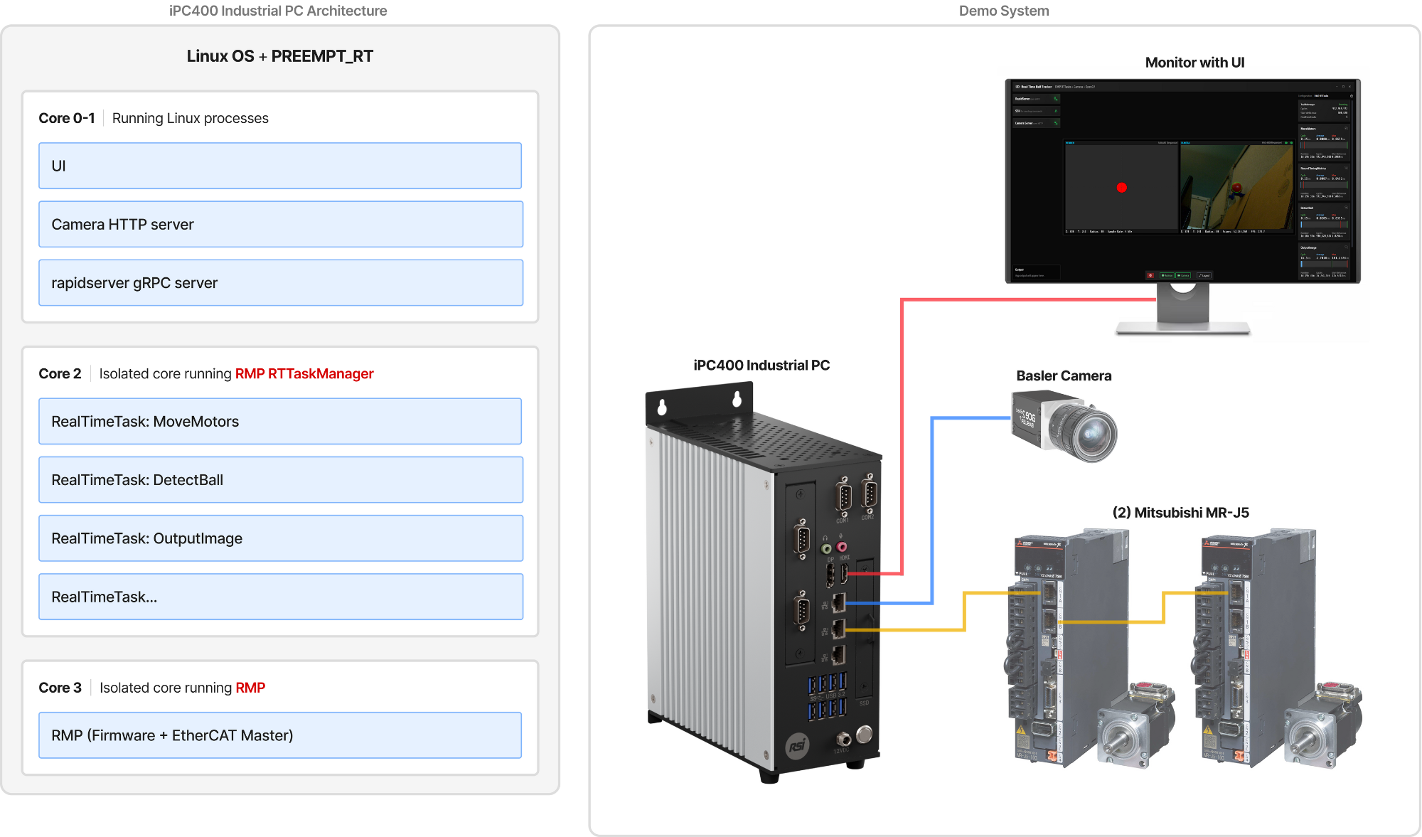

The demo integrates a complete vision-guided motion control stack, combining industrial-grade hardware and software components:
  • Processing: iPC400 Industrial PC running Linux with PREEMPT_RT enabled to ensure real-time deterministic performance and motion, and executing OpenCV for color tracking and vision processing.
  • Motion Control: RSI’s RMP EtherCAT Motion Controller with the RapidCode API, enabling real-time deterministic motion and I/O control.
  • Drives & Motors: Mitsubishi MR-J5 EtherCAT series servos for precise two-axis gimbal movement.
  • Camera: Basler industrial camera with the Pylon SDK for ~6 millisecond fast image acquisition.
Diagram showing an industrial PC, monitor UI, camera, and two servo drives connected for vision and motion control

Real-Time Operating System (iPC400 Industrial PC + Linux + PREEMPT_RT)
At the foundation of this system is the RSI iPC400 Industrial PC, powered by an Intel® Core™ i5 CPU with Time Coordinated Computing (TCC) support. This processor is specifically optimized for real-time latencies, enabling deterministic scheduling and ultra-low jitter performance. When combined with Linux and PREEMPT_RT, the iPC400 delivers a reliable real-time operating environment for executing vision processing and motion-control logic. By providing predictable response times and rock-solid timing precision, the iPC400 ensures that RSI’s platform, not just the cameras, is at the heart of achieving high-performance vision-guided motion control.
Real-Time Performance
PREEMPT_RT makes the Linux kernel fully preemptible, allowing high-priority motion control and vision-processing tasks to interrupt background processes without delay. This reduces interrupt latency to the microsecond range and ensures smooth and consistent execution of the demo’s 4 kHz control loop.
Vision acquisition, OpenCV-based tracking, and motion commands run as high-priority real-time threads, while non-critical services are isolated on other cores to minimize interference.
