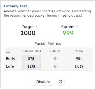

Running the RMPNetwork on the NVIDIA Jetson Orin Nano at a 1 kHz sample rate for 14 hours, the maximum send delta (the time between sending an EtherCAT datagram out to nodes on the network) reported by RapidSetupX was 1019 microseconds. A C# utility program for parsing the recorded timings reported that the RMP firmware delta had a maximum of 1018 microseconds and the RMPNetwork receive delta was 1019.
Our default threshold for considering a packet as late is 12.5 % of the sample period, which the Jetson Orin Nano was well under.
显示 EtherCAT 数据包时序目标、当前延迟和数据包指标的延迟测试面板截图

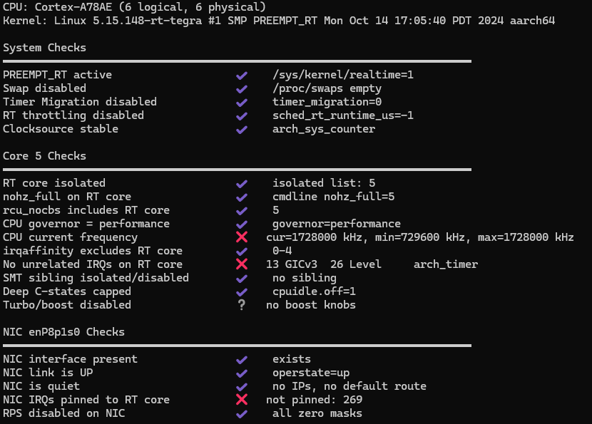

Using rmp-eval (GitHub – roboticsys/rmp-eval: An open-source Linux utility for evaluating a system’s real-time performance and RMP EtherCAT suitability), we managed to tune the Jetson Orin Nano to have the configuration shown in the screenshot below.
With regard to the pinning of IRQs, it seemed like we were unable to pin IRQs to an isolated CPU on this version of the Linux kernel, which may affect jitter on systems with a high workload on the non-isolated CPUs.
‍Latency Test Result (Jetson Orin Nano)
终端截图,显示 Linux CPU、核心和 NIC 实时系统检查及状态标记

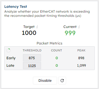

When running for 14 hours on the Raspberry Pi, the RMPNetwork’s maximum send delta was 1099 microseconds. The recorded maximum RMP firmware delta was 1109 microseconds, and the maximum network receive delta was 1101 microseconds.
延迟测试面板截图,显示目标和当前时序以及数据包指标

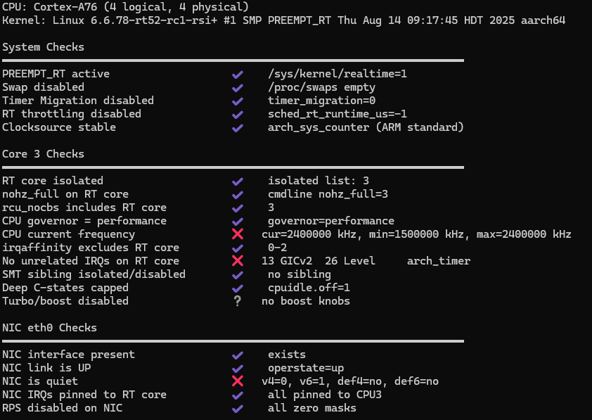

The configuration report from rmp-eval showed:
‍Latency Test Result (Raspberry Pi CM5)
终端系统检查界面,显示 Linux 实时、CPU 核心和 NIC 状态及通过/失败图标
