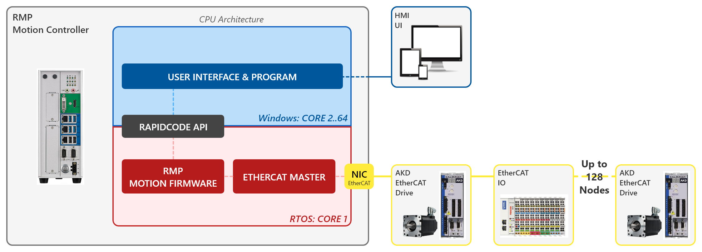

1. Hardware
The RMP® is a software-based motion controller and runs on standard Industrial PC hardware. Hence, no need to worry about components or controller hardware going obsolete.

Most OEMs run RMP with drives in the position loop. Closing the position loop in the EtherCAT® drive is better as the drive's internal interpolation sample rate is high. SynqNet closes the torque loop in the controller. Therefore, with high axis counts, the SynqNet controller sample rate has to be set lower which leads to lower system performance when closing the motor's feedback loop.

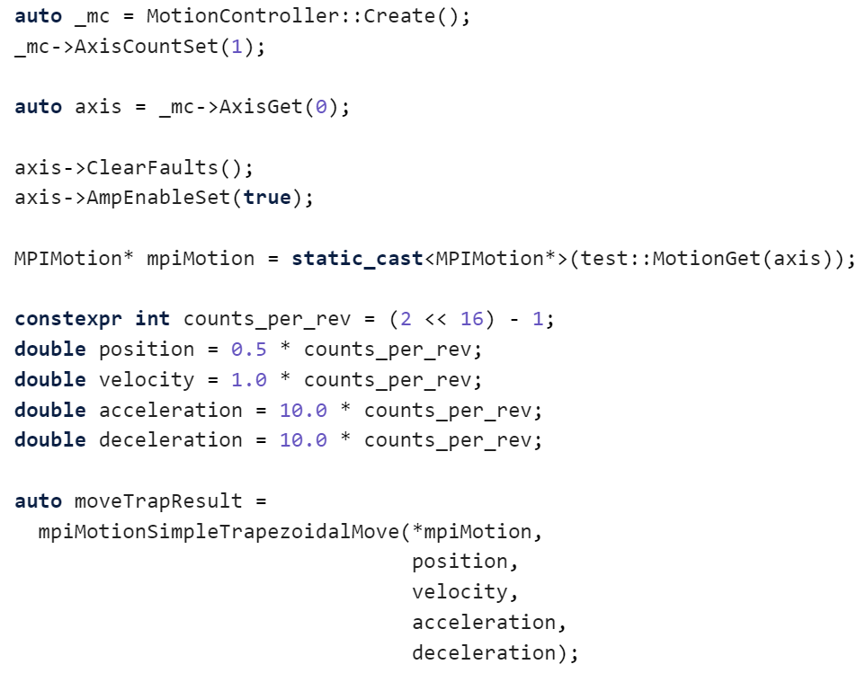

The RMP EtherCAT® supports MPI API (C language). Current SynqNet™ OEMs can leverage MPI and utilize a modern and popular communications layer (EtherCAT®) with minimal effort.

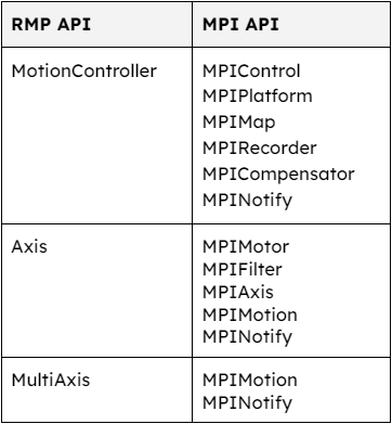

Most of the machine’s source code will remain untouched. The primary changes from migrating to the RMP EtherCAT® will be made to Network Initialization and Homing. Here on the right is a list of supported MPI objects using the RMP EtherCAT® motion controller.

RMP’s RapidCode also supports other languages such as C++, C#, and VB. NET. For non-Windows programmers, utilizing RapidCodeRemote gRPC services enables OEMs to use many more languages such as Python, Java, Ruby, Dart, etc.

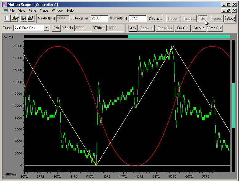

Valuable tools such as MotionScope and BodeTool remain unchanged, lessening any learning curve for the engineers and technicians.

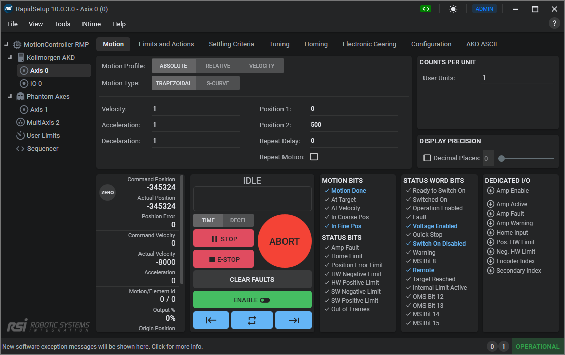

Improved MotionConsole
RapidSetup was designed to organize various aspects of the MotionConsole better. RapidSetup has a clean tree view format making it easy to view axes, especially when high axis counts are involved. RapidSetup also allows engineers to rename various axes and IOs making it easier to control the multiple products in a machine.
