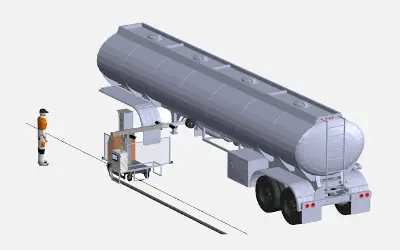

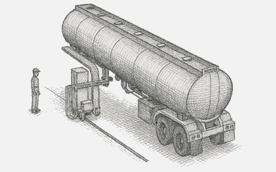

The proposed solution includes a customized Robotic AGV Platform that navigates along a magnetic tape on the floor on a straight line parallel to the tanker trailer.

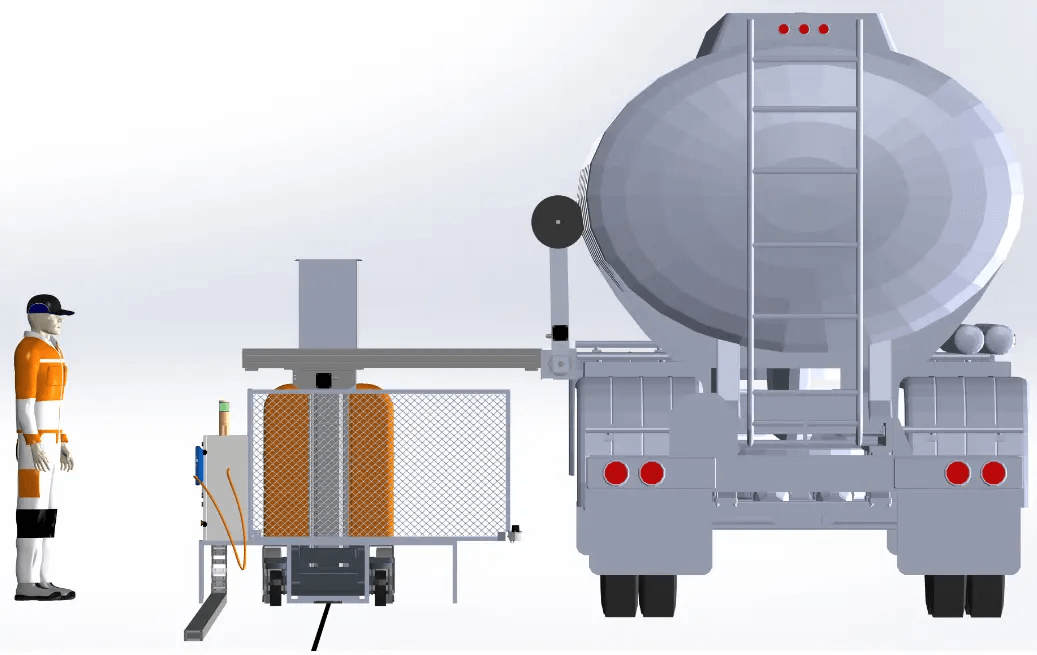

The custom robotic AGV has a vertical mast with custom buffer arm and tooling so it can polish both the top and bottom of the trailer.

RSI designed an intuitive user interface using an Xbox controller; enabling operators to maneuver the robot tooling across the buffing surface and around obstructions. The PC based application included a semi-automatic mode where the robot would “re-trace” paths to reduce polishing time.
